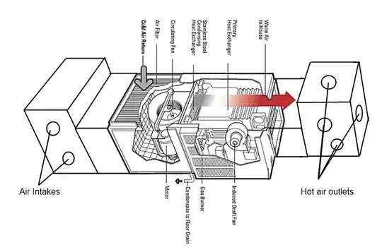

I have a Lennox G40UH(X) series furnace, which is installed in our attic (We have a single-story house on a slab). Because the furnace is installed in the attic, it is "laying down" on its side, and the incoming air is piped into what would be the bottom of the unit if it was standing up. We have intake vents in almost every room of the house (small vents, about 12" long by 8" tall). These vents go up to the attic, and they're all routed into a big metal box which is appears to be welded to the bottom of the furnace.
Because this is kind of hard to imagine, I mocked up a little image of my setup (this isn't my actual furnace, just a similar picture I found on Google):
furnace mockup
I have flexible ducts leading to the cold air intake "box" that is welded to the bottom of the furnace, and round flexible ducts leading from the hot air "box" to all of our vents (which are in the ceiling).
The problem I am having is that I can't see where to install a filter! I can remove the front panel and see the bottom motor, but there's no where to actually put a filter.

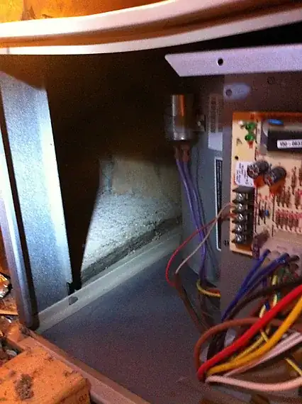

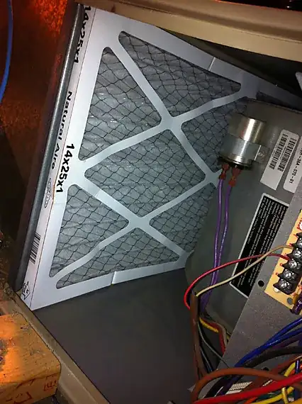

Update: As is usually the case with me, I put off worrying about the furnace until it started getting too cold here at night. I finally climbed up to the attic and took a good look at the furnace. There isn't any indication of where a filter should go, and no slot to slide it in or bar to hold it in place.
This is the air intake area - you can see the circulating fan on the right, behind the control board:
alt text
I put the filter along the bottom - a 14x25x1 fit snug across the whole side (bottom if it was standing up). I had to fold and bend the filter some to get it inside the furnace. The only thing that seems to hold it in place is the body of the circulating fan:
alt text

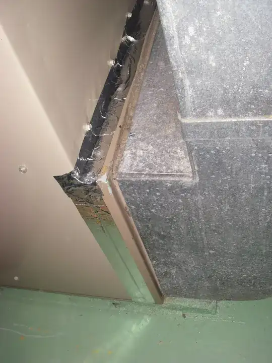

Usually the filter is mounted between all the return ducting and the furnace itself - potentially it is installed at a strange angle or covered up with tape or something. Here is a picture of mine, it's the darker colored piece the duct is attached to, with foil tape sealing it to the furnace housing.
pic of furnace filter housing

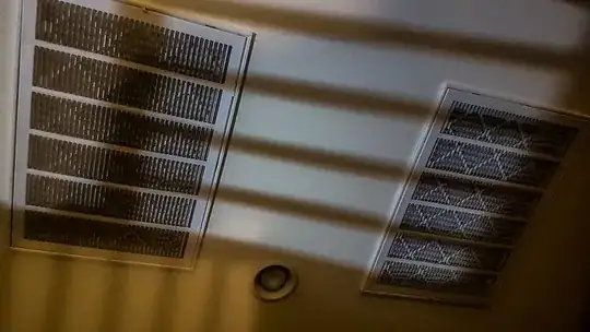

  1. If furnace is located in the basement then filter is placed at furnace between intake ducts and blower motor.
  2. If furnace is located in the attic then filter is placed at intake ceiling vents. enter image description here
If none of the above, then stick one any size that can fit in between intake ductwork and blower motor.

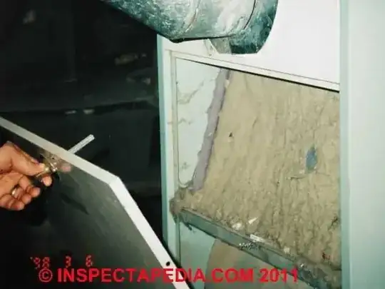

At my old house, there wasn't a slot to put the filter into. Taking the door off the side showed me the motor, like you've said, which was situated inside the cold air return chamber (much like your picture). The filter rested on two notches on the outer edge of the chamber, and basically blocked my view of the motor. See if there's a way to place the filter "in the way" of the cold air as it passes the motor.
This disgusting image shows how the door opens to reveal the motor, and the air filter is placed at an angle in the way of the motor. Air flows from above and hits the angled filter.
furnace picture (source)

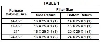

Page 28 of the installation manual (PDF) says this:
Filters
All G40UH(X) filters are installed external to the unit. Filters should be inspected monthly. Clean or replace the filters when necessary to ensure proper furnace operation. Replacement filters must be rated for high velocity airflow. Table 1 lists recommended filter sizes.
Table 1
