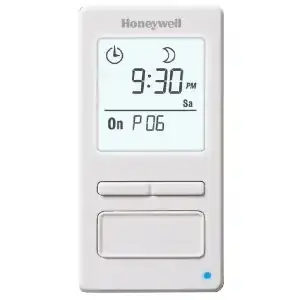

One option that would avoid putting a DIY gizmo on your home electrical system in an abusive environment* is to run some romex down from the attic to a convenient location and install a timer switch. Then you can configure it to be always on in the spring/fall, always off in the dead of winter, and run it on a timer to get the last of the cool air in the morning and exhaust what you can in the late evening:
*My personal experience with electronics in the attic itself is that they have a bad habit of melting or frying the transistor. And my personal experience with attic fans is that they have a bad habit of breaking and create another hole in the roof that exposes the attic to the elements or a potential leak. So when I had my roof redone a few years ago, I just had them remove the old unit (it was already broken from a failed bearing) and patched the roof with a new sheet of plywood.
