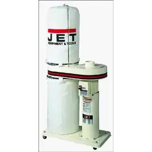

I have my entire woodworking workshop in my basement. Plenty of people have basement workshops. Just get a portable dust collector like this one:

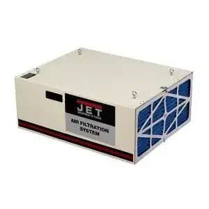

Get good filter bags that filter down to at least 5 microns, smaller is better. And a remote controlled air filtration system like this one to hang from the ceiling.
Drill presses make very little dust. Bandsaws make more. Tablesaws, routing and sanding make significantly more. Get a good dust mask. Those flimsy paper ones with the rubber band strap are useless for the real dangerous tiny particles.

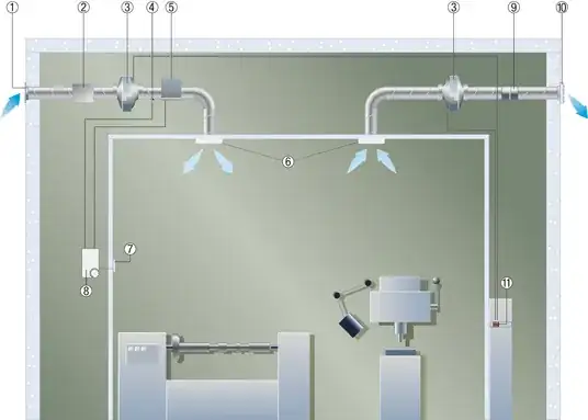

Yes it will be unhealthy... if you dont have any ventilation
1- MLA / MLZ external grille
2- Filters (hepa/etc)(not required in your situation)
3- a reliable higher quilaity not el-cheapo air fan
4- sensors (not needed here)
5- heater/cooler (not needed here)
6- Grilles
9 - AVM Backflow preventer (important)
10 - AS shutter
7,8 - Switches (not needed here)
It is a good idea to wear and dust mask when machines in operation aswell.

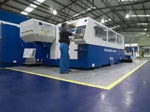

I am not saying your basement must look like this.. but you can get a good idea of the space needed around a machine governed by industrial health and safety (for idiots)
