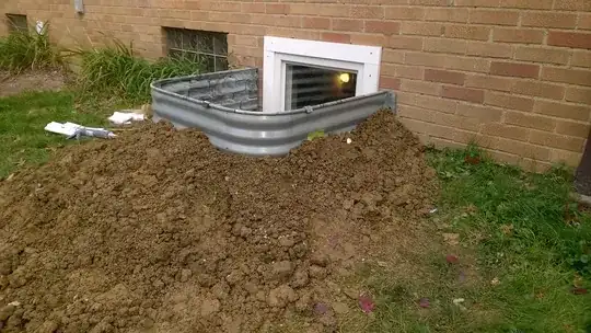

Is there code on this? I am having an egress window well installed today and was surprised to see the window well sticking out 2 feet above ground (1 foot if you count all the new dirt they mounded up around it). I was surprised because in all my research, most of the wells seem to be closer to flush with the ground (very few images I see on Google image search seem to have the well set so far above ground). It is far more of an eye sore than I was expecting for the $4,000 price tag associated with the work and the initial pictures I was shown before signing a contract.
The installers said it is required to have it set above ground so that people do not fall in and that most people cover the wells with shrubs, but I do not recall reading this in any applicable building code and it seems like planting shrubs to cover up a fire escape seems like a generally bad idea.
Can anyone confirm whether what I am being told is correct with an applicable code reference (if one exists)? If it is not required, I definitely want the well set an appropriate depth (or a shorter well placed) as I am unhappy with its appearance and would prefer to not have to do my own decorative brick work to cover it up.
Here is a picture of the egress window well: enter image description here

Obviously there may be local restrictions, but on the 4 wells I had installed last year they highest one is about 3" above the surrounding ground level.
I agree - that looks rather awful. I'd definitely ask them to replace it with a better sized well. My guess would be that was the one they brought and they didn't want to deal with having to go get a shorter one from their warehouse.

The tops of my window wells are 0" - 2" above ground level. My grass is 1" - 3" high, so the tops of the window wells are about as high as my lawn. My window wells are the same style as yours.
On some of my window wells, my builder correctly installed them at this level, and they passed inspection.
On my remaining window wells, my builder mistakenly installed them too tall. I cut them down to their current height. I glued on two layers of rubber tubing to the cut edges, so that they would be safe to handle. (A person climbing out of the window well is likely to put their entire weight on their hands, while gripping the top edge of the window well.) This process exposed some of the window trim, so I sealed the exposed trim with butyl rubber, added wood patches to complete the trim, and painted the patches. As a bonus, lowering the window wells resulted in more light in my basement, plus eye-level views of cats, birds, and squirrels on my lawn.
