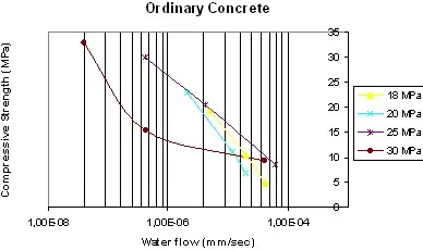

I speculate that the waterproofness of M1 ~ M4 mortar can be loosely determined, as they will each have a given cure strength according to ISO 13007.
  • The permeability of concrete decreases as its strength (and age) increases:
From the presented results it was possible to present correlation curves with compressive strength, age and characteristic strength compression versus the passing water flow trough it.
–International Symposium (NDT-CE 2003) Non-Destructive Testing in Civil Engineering 2003, Permeability of Concrete: A Study Intended for the "in situ" Valuation Using Portable Instruments and Traditional Techniques
