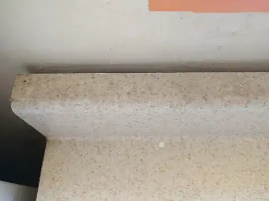

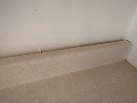

The kitchen in the rental house I live in has a counter which was installed rather poorly - there is a gap of about an inch between it and the wall, and mice are able to scurry up this to the kitchen counter. I would like to seal this gap.
We've put out many traps, and tried our best to remove any potential sources of food, but it's an old house and we seem to constantly have mice problems in the winter, so sealing this gap would provide some peace of mind as it's the only access route to the kitchen counter.
One idea would be to use plastic tubing like this, only the gap varies between 1/4" and 3/4" in width, so we'd need to add a layer of sealant or something on top. The gap is too large to use caulk alone.
Any help would be greatly appreciated! enter image description here Gap on right

Another option is to buy a piece of decorative molding, whose bottom edge is at least as thick as the gap. Just attach it to the wall, setting it directly against the top of the counter's backsplash to block the gap. Caulk if desired. If you screw it to the wall instead of glue, you can remove it if the landlord doesn't like it.

This gap is too large to fill with caulk alone, but you can fill it and then caulk over the top. Using rubber tubing is an OK idea, and should work, but there are other products which are specifically designed for this purpose.
You can use foam backer rod, also known as caulk saver to fill the space behind the counter top. It comes in many different sizes and you should find one that will fit that gap. The benefit of the backer rod is that it can be compressed more easily to fit tight areas. It usually is also a cheaper solution.
To hold the rod in place before caulking you can put a few dabs of caulk on it to keep it from dropping down too far if certain areas of the gap are too big. You should position the backer rod about 3/8" to 1/4" below the lip of the counter so there is enough space to put a good layer of caulk down without having a raised bump there.
I would recommend a silicone caulk that is specifically designed for kitchens and bathrooms. Also, try to find one that matches the color of the counter top as closely as possible. A trick to get a clean line of caulk is to put masking tape on the wall and counter and leave an even gap. Squeeze out a bead of caulk, and then use your finger to smooth it out. Wait about 5 minutes, and then carefully remove the tape. This should leave a clean line, and there shouldn't be any excess caulk.
