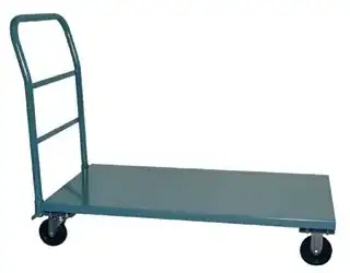

I think you need something that's low and narrow. A strong metal platform truck
might work, the hard part would be wrestling the blocks onto the platform. You probably also have to lay plywood on the ground ahead of the truck, I imagine the wheels would dig right into the ground. (I've never seen one of these with outdoor type wheels.) If you used two 8' pieces of plywood, cut narrow enough to get through the gates, you could swap them around and go 8' at a stretch.

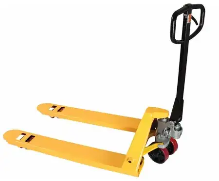

A palette jack
palette jack
might be a better bet, it would probably be fairly easy to use a lever to get some wood under the center of the block to raise it high enough to lift with the palette jack. You could even build a palette for the blocks if that's easier.

I'd definitely second the pallet truck suggestion. I've got three and they can all handle 2000kgs (4400lbs) so weight is no problem. Use a pair of bars on wood packers to get it up off the floor until you can get trolley jacks underneath it. then run the pallet truck under it and lower the jacks.
Just set up some planks or 3/4" plywood (as long as there are no big dips in the route) for the solid wheels to run on.
