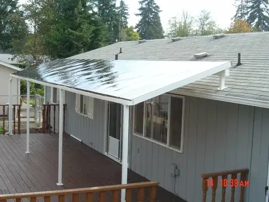

Finally, it sounds like the low-slope is due to a desire to install below the existing gutter. I'd suggest not doing that and install above the gutter. There are a number ways to do this. Here's an example of one:

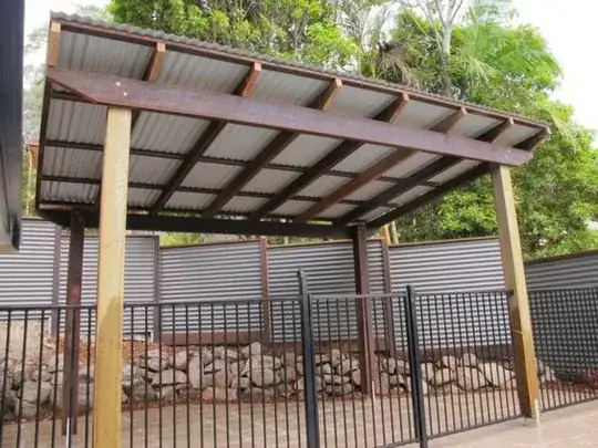

The supporting structure (a pergola) is what's going to 'hide' the corrugated material. If I can see corrugated roofing from the ground, I expect it to be supported by one. Otherwise it does look really tacky.
Pergola With Corrugated Roof: (Google image search)
Although I'd suggest going with metal for durability (and as pictured), neither material in and of themselves have as much say on aesthetics as the entire design aspect does. You don't hide it: you incorporate it.
I will say though, that no matter how you support it, using metal instead of plastic is the first step in making me think you ever cared about aesthetics. The house I grew up in had a plastic one that turned ugly yellow, developed cracks and eventually shattered.
With no picture of your house, I can't advise on how to tie it in, but my point is that it doesn't have to. It can be its own 'thing'. And if your house is plain looking, it may BE the only thing, and then you can (and should) design it to your heart's content.
An alternate way of looking at it, is to ask yourself how you can make it stand out in lieu of hiding it. When I say "it" I mean the entire project, not just the roofing. Also with the proper artistic touch (and especially once it starts rusting), using metal puts you into the realm of shabby chic or rustic, both are far from the land of cheap mobile home.
