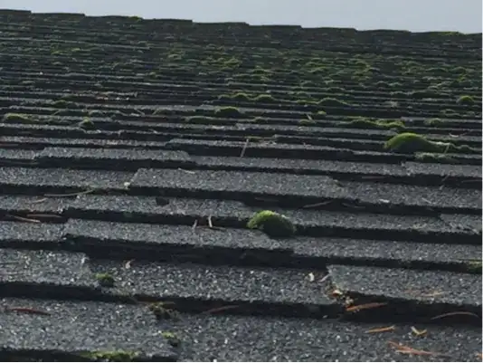

I live in Seattle. My 6 years old composite shingles start to grow moss this year.

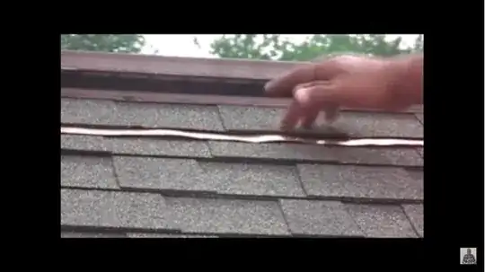

I read one post on YouTube that you can use a long zinc strip placed on top of your roof to prevent moss. I am wondering how effective it is. Another post mentioned that one strip can stop moss growing for about 15 feed down, so I need a few more strips to make whole roof protected.
Any thoughts and experiences? enter image description here

I live across the water from Seattle. I've seen several houses around here with zinc strips. They also have moss on the roof. I think there's no stopping moss in this climate on composite shingles.
