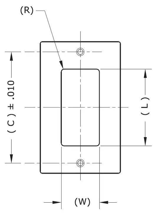

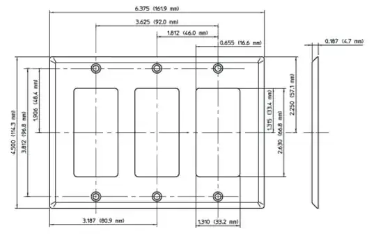

3 gang Decora cover plate drawing
NEMA WD 6-2016, page 5 says: Wallplate Dimensions for Rectangular Face Devices
W: 1.310 (min)
L: 2.630 (min)
R: 0.094 (0.079 347V)
C: 3.812 (4.062 347V) +/- 0.010 (counter-sunk for #6-32 UNC oval head machine screw)
Application (Face of device): 1.300 (max) W x 2.620 (max) L
page iv notes: (#1) dimensions are in inches (#2) tolerances are +/- 0.005 (#10) dimensions are for interchangeability and do not preclude other designs.
