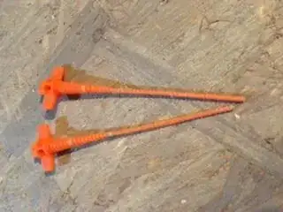

Much like the bolt suggestion, I found these at a hardware store several years ago and have used them regularly. They are actually called caulk savers. Unfortunately, I don't recall exactly where I found them, but I have seen them around from time to time. I did use them to save some silicone at one point, but only for a few days, maybe a week or so. I doubt it would work any better than a bolt or screw. I don't have any scientific basis for the next thought, but my suspicion is that once silicone contacts air, it starts a slow irreversible curing process.
