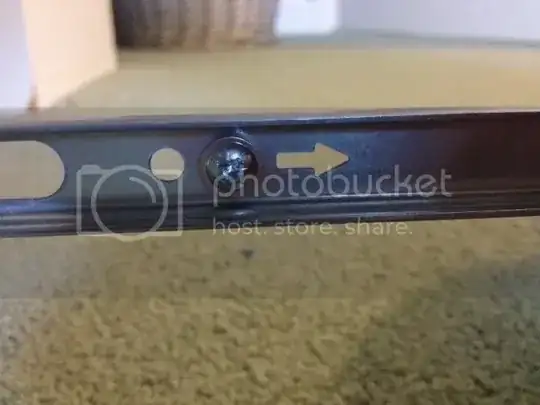

A view of the screw head from the outside

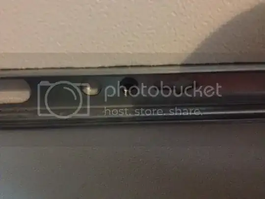

A view of the screw thread from the inside

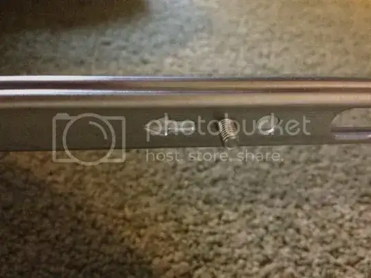

And this is a view of the thread on the castors/slides (from the outside) from one of the ones where I haven't put the screw in yet. You can see that there is a little bit sticking out with some thread on the inside:
The thread on the castors

As you turn the screw to unscrew it, press on the "point" of the screw to counter the force on the screwdriver trying to push the screw back into the drawer runner. That should allow it to unscrew.
John
  • 2,440
Had the exact same issue.
Hold onto the screw from the other side with some pliers to apply pressure, and then unscrew.
Alex
I've just bought the same unit and done exactly that.. I've been scratching my head on this for a number of hours then I came across this and I tried it with the back of a metal keyring (credit card size) to apply pressure and both screws have come out ok and have been screwed in now as per instructions.. I'm glad I came across this now and it does work

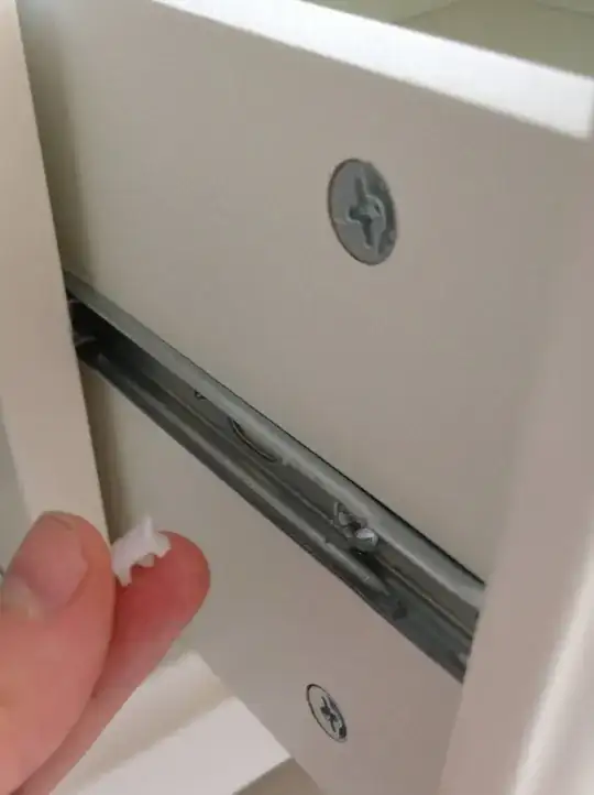

I tried removing the screw by applying pressure on the tip of it but it didn't work for me. Probably because of the beating the screw had taken after trying superglue, hammering and a soldering iron to get it out. I ended up taking out the plastic part that was stopping the drawer from closing. Now it works well except for a small clunk sound everytime I close and open the drawer. plastic part
