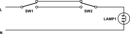

You need two wires running between two 2-way switches. The common terminal on one switch has the live feed. The common terminal on the other switch is connected to the light bulb. The light will turn on if both switches are up or both are down.
schematic
No matter what they call them - they're 2-way switches. They can only be one way or the other.
If additional switches are required then cross-over switches are inserted between the other two. These have four terminals and connect straight through in one position and swap over in the other.
Isolate the circuit completely at the fuseboard before starting work, confirm the circuit is dead and don't switch back on until completed.
