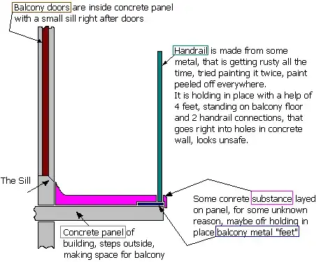

Balcony construction from side view
I removed that strange concrete substance, as it was shattered by wear and tear. There was an asphalt board between this layer and building panel, that allowed me to remove that layer with ease.

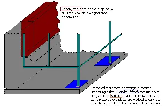

Isometric view of balcony front and edge

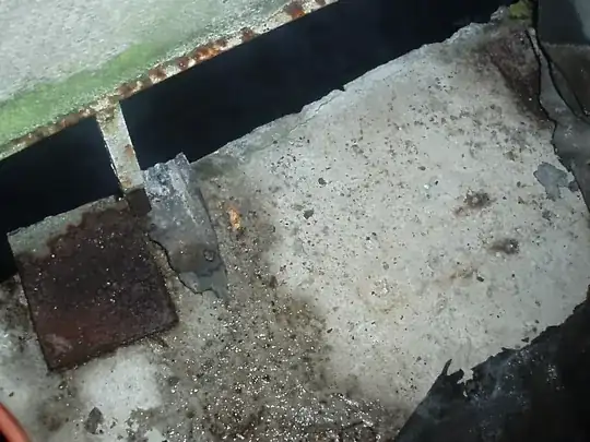

  • Highest place, where metal feet is out of concrete panel (in picture 7): 25mm

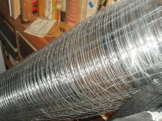

  • Wire diameter of bought armature (in picture 8): ~0,9mm

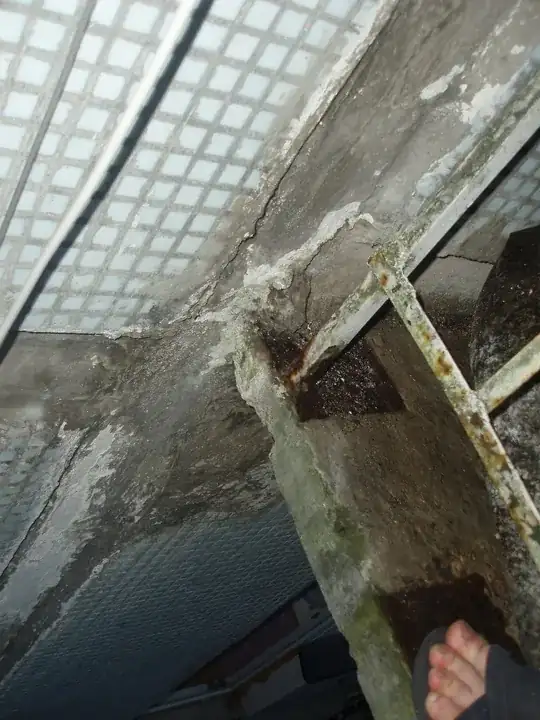

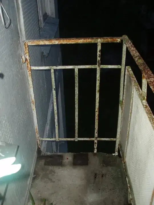

Far end of balcony Sill and building panel space Closer end of balcony, from outside Conrete panel and handrill feet Metal armature, that I have bought already

Do I need to clean/set up those metal parts, cover with something, to stop rust and not let the flexibility of metal handrail shatter my new layer.
  • Prepare and clean the existing metal hand-railing:
    • Use a wire-brush, steel-wool, wet & dry sandpaper to remove as much flaky/loose material as possible.
    • Wash down everything with a mixture of warm water and washing (dish) liquid. Rinse off thoroughly with clean water. Allow to dry, then wipe down with something like White Spirit (paint thinner).
    • Paint (primer) everything with a rust inhibiting primer.
    • Then paint/spray everything with one-coat of a good quality exterior enamel.

Do I need any layers between building panel and my new layer?
  • Paint the top face of the existing balcony concrete slab and up the face of the sill with 2 coats of bitumen paint. This will provide some protection to the existing concrete from moisture penetrating down from above.

How thick a metal armature will be enough for this job?
  • That will be fine, just place a single layer in the middle of the new concrete top slab you pour.
