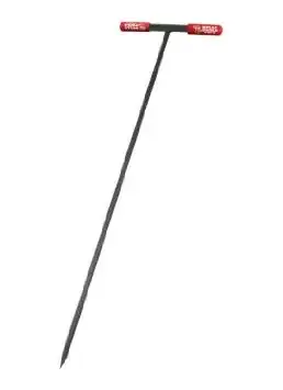

Use a soil probe. Commonly used item for plumbers and landscapers:

  6. The soil probe is not a bad idea. Try to narrow down the area its in first.
