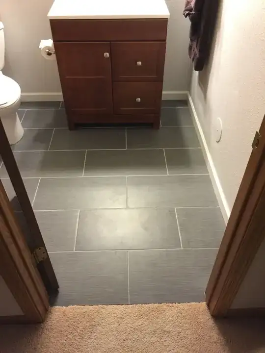

I can report back. I started and stopped this job on three different days with no ill effects (as of a year later). I was sure to cleanup any excess mortar that would interfere with the pieces to be laid later. I also kept at least 2 days between each session so I was not disturbing the existing tile; although that was more due to my available time and less about the job itself. Here are the results:
