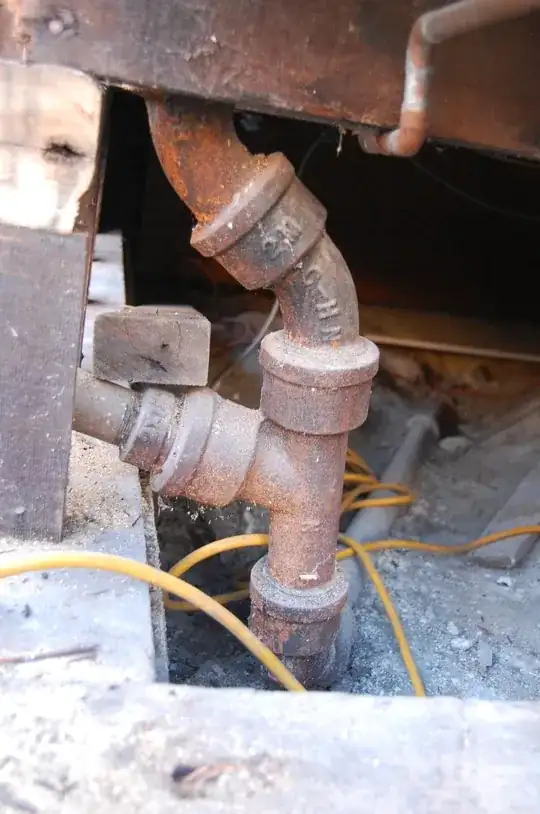

I have a 2" section of ductile cast iron pipe that's in the way of a framing repair job. This pipe needs to move.
The cast iron dates to the original construction, 1938. As was customary at the time, the cast iron was joined with oakum and pure metallic lead.
In the middle is a modern retrofit that's horrible, with no actual seal between a plastic retrofit and the 1938 cast iron. This section serves a single modern sink and dishwasher. Fixing the modern plumbing is no problem. How do I cut & tie into the 1938 cast iron? I have heard that removing the lead is both hard, and will send lead chips down the sewer.

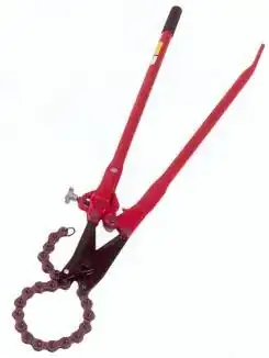

My local library offers a compression snap cutter for cast iron pipes.

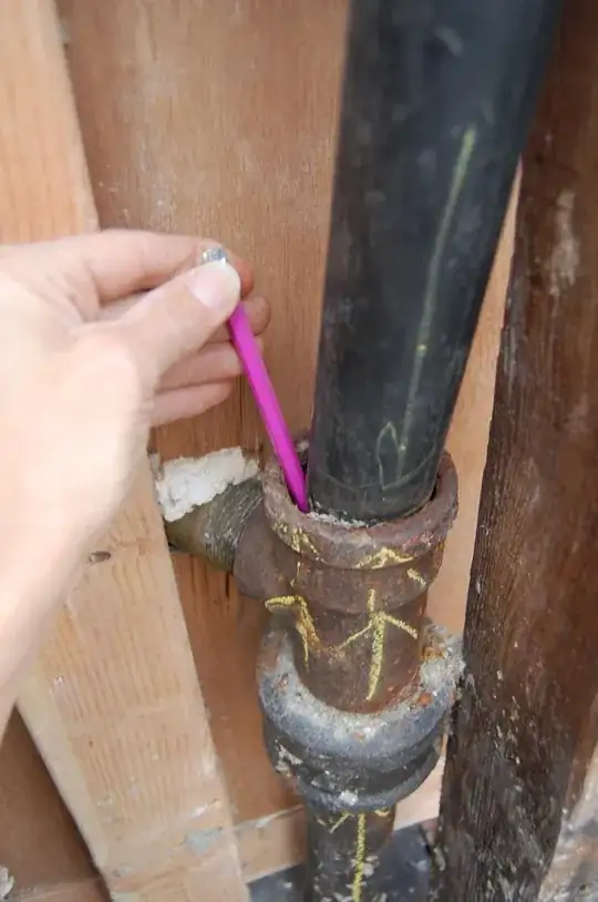

2" cast iron pipe and cleanout Lovely job tying in old cast iron to a new plastic vent

I would consider cutting the whole mess out at the bottom end and connect A new “ABS” black pipe with a “no hub” it is a rubber connector with bands on each end to tighten then tie into the upper area . This will be much easier than packing oakum and poring the lead on top; everything can be fitted together prior to gluing so you know it is right where you want it then glue and know u fixed the mess.

Cutting Cast Iron Pipe
The most common and quickest way to cut cast iron is the by the use of snap cutters. There are two types: scissors and ratachet.
You can also cut cast iron with (in order of fastest to slowest) angle grinder, a reciprocating saw or a hacksaw. In order to use a grinder, you'll need room all around the pipe.

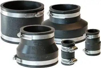

Connecting to Cast Iron Pipe
You connect to cast iron pipe by use of a rubber coupling with gear clamps. The most commonly used ones when adapting to plastic is referred to a Fernco:
They make them in all sorts of size combinations. You just need to know the material and size that your connecting together.

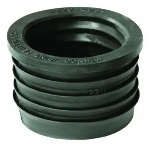

Connecting to Cast Iron Hub
You can connect plastic drainage pipe to to an existing cast iron hub by use of a rubber donut insert:
Fernco makes such a product (manufacture's site) that can be bought in hardware and plumbing stores or from Amazon.
