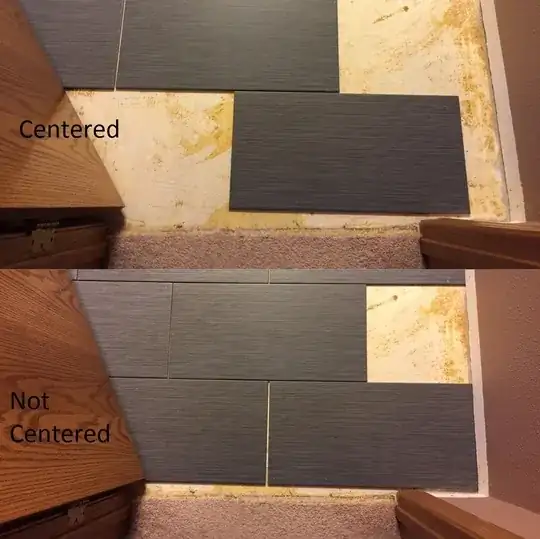

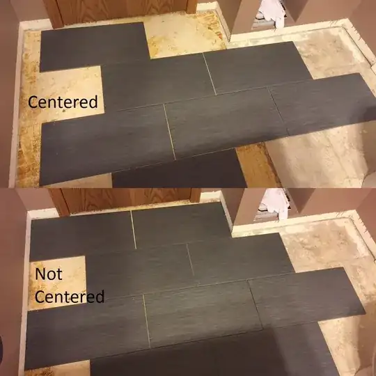

I am tiling a small bathroom ~45sq ft. The book I am referencing suggested starting the tile in the center of the room to prevent laying any tiny fractions of tile near one side of the room. I'm working with 12x24" tiles and it looks like I might be better suited with starting the tiles at the door threshold. Is the start at the middle idea just a guideline that I can go ahead and break?
Door area comparison
Overview comparison

The two things (starting in the middle and avoiding slivers) are NOT related.
You can start in the middle and end up with idiotic cuts on both edges - or you can start in the corner and not do that...
What you SHOULD do is measure enough that you know where to put the SENSIBLE cuts on the edges, regardless if you are starting at a wall, corner, or the middle of the floor. When starting in a corner or at a wall, your very first tile might well be a cut tile. By planning, you know what cuts you are making and can place the whole and cut tiles as you like. In your case, the first two-and-a bit tiles at the door should probably be cut so that there's not a large gap at the threshold (or you need to get the door molding cut so they can slide under it.) Depending how the (invisible) far wall (opposite the door) comes out, you might want to take enough off the "door" tiles that the wall parallel to the door does not have what looks to be a 1-1/2" slice running along it.
The main argument I've seen for starting in the middle is to avoid following an irregular wall - but you can do the same thing by striking a chalk-line where the first grout line from the wall would be, and pre-cutting all the tiles for that wall if it's irregular (or if they will be half or 1/3 tiles so the far wall isn't slivers - which you'll know because you measure it.)
Based on your pictures, I'd choose the "not centered" approach, since the visible far wall is decidedly not slivers that way, but that's purely an opinion call, not "right" or "wrong."
Yes, starting in the middle of the room can be a bit un-nerving. There's no reason not to begin in another location ; as long as you're comfortable with the appearance of cut tiles along the wall. For the sake of balance and uniformity It would be wise (as you noted) to begin at the most trafficked entry point working out and away into the room. I always found you get the best look from the tile if you can install full tiles to be in view when the door is open. So looking at photo #2 you see more full tiles and fewer cut tiles. This will also produce less work in that you won't be going back to the tile saw constantly and there won't be as much waste. You might want to trim the door molding so the tile can fit underneath rather than notching angled cuts. Keep your spacing along the wall as close to the joint spacing as possible if you don't intend to install wall molding (it will look neater). Any grout joint over 3/16 inches you will want to use sanded grout for a stronger grout joint.

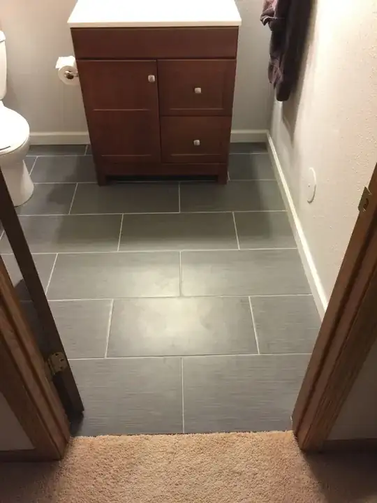

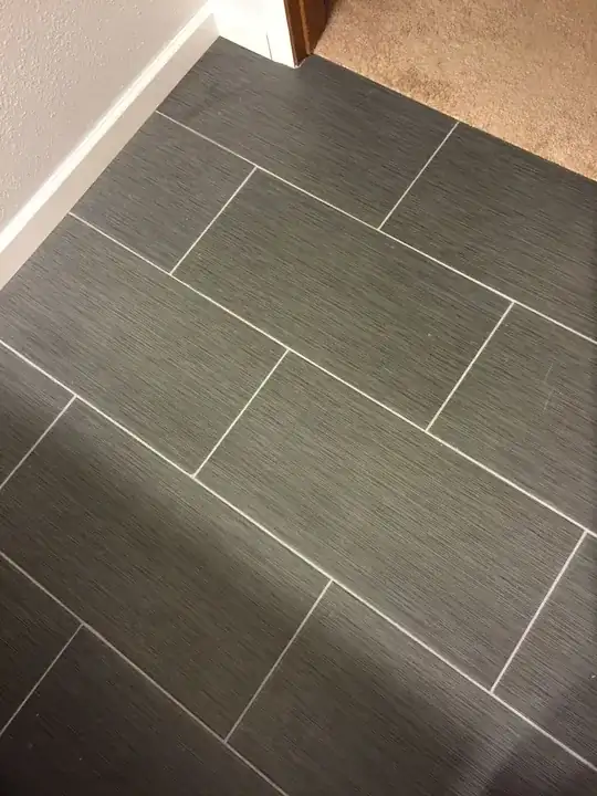

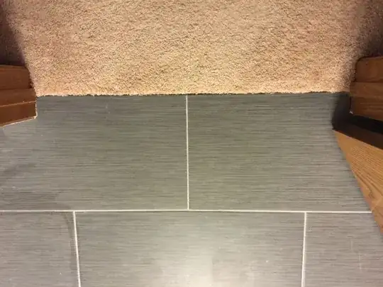

I followed the advice given here and went with the "non-centered" approach - to ensure that the threshold looked good and not start in the middle of the room. Here are the results:
Threshold The whole room Threshold corner Overview of entrance
