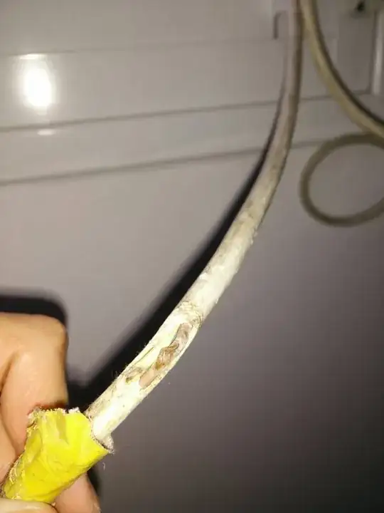

I have this wire some of the inner part of which is exposed. My friend claims that this is highly dangerous, but I don't think that touching it would be lethal, and in the worst case scenario there might be a short circuit, though the plug is grounded (3-prongs). I don't understand enough to know this myself...

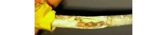

Given the colours (I don't know why the other answerer referred to a red wire, the wire in your picture is clearly brown) I'm going to assume you are somewhere in Europe.
The insulation on the nominally live wire is gone, that means you more likely than not have 230V exposed (if you are in a country that cares about polairty you definately have 230V exposed, if you are in a country that doesn't care about polarity it's 50/50). Touching that is very likely to result in an electric shock, if you are unlucky said shock may be fatal.
There is also earth exposed. With some movement you could end up with a short circuit. Most likely this will blow a fuse/trip a breaker but if you are unlucky it could also start a fire.
I would advise against using insulation tape to repair mains wires except in a dire emergency. It insulates fine but the adhesive can lose stickiness over time. If you do insist on using it make sure you remove the outer sheath, insulate the damaged wires individually and then insulate the bundle.
Best option is to replace the cable, if that is not possible then it may be possible to cut it and insert a suitable joint.

Short: Yes - the wire is lethally dangerous
It could kill somebody.
It could cause a fire.
Longer: If that is a mains power cable, as it seems to be, then that wire has the potential* to be fatally dangerous if touched when power is applied.
Let's try that again
  • This can easily kill somebody
  • The lead could cause a fire - either by energy transfer from the bare wire to other grounded or semi grounded objects, or via the other also exposed conductor.
It appears to be a two conductor cable, but even if it has 3 conductors the danger is just as real. (The other visible conductor is also damaged, adding to the danger of electrocution and/or fire).
The colour suggests that this is the 'live' or 'phase' conductor, but even if the plug has been wired wrongly and that this is not the "Phase" conductor it could still kill somebody worst case.
Somebody has apparently covered the faulty area with tape which has been removed for whatever reason. The tape MAY make it SLIGHTLY safer but may not. If the lives concerned (yours or other users) are worth more than a few dollars then you should replace the cord or have it repaired competently.

You haven't told us which country you live in, or what this wire connects to. (It makes a difference if it's say, a refrigerator or microwave oven, as opposed to a small room fan.) Still, if it's connected to your mains (115/230V) power, as others have mentioned, your friend was right: that wire's a serious accident waiting to happen.
In addition to the excellent answers you've already received, let me add a couple things that I hope will be relevant not only to you, but others in similar situations:
Sanity check
Whenever I find myself pondering things like the following, a sanity check is surely needed:
I think an important test is that you've a) been told it's dangerous by someone who presumably cares about you, b) you have willfully rejected that advice, yet c) you haven't actually tried touching it yet! (DON'T try touching it. Please. Possibilities range from no sensation, to a light tingle, to cardiac arrest.) I'm glad you've come here for advice, and please consider getting your friend some flowers or something.
Mostly country-agnostic practical advice
Step 1. Unless it's connected to some actual life-support equipment or other vital systems, unplug that cord now, then cut the plug off so nobody else plugs it back in.
Now that your life and home are no longer in danger, you have a few options (subject to local law/regulation of course):
  • Check the device. If you're lucky, the entire cord may be removable from the back of the machine, making replacement cheap, easy, and safe.
  • Replace the entire device and recycle the old one. Especially if the device was inexpensive, and if you are not skilled with wiring, this may be a very reasonable option.
  • If permitted by local law, you can cut out the damaged section of cord and re-attach the plug (or attach a new plug if the existing one is damaged—the plug is not visible in your picture, so we can't tell). If the damage to the cord is too close to the device itself (say, less than a metre), the entire cord may need to be replaced.
    For an experienced electrician, either repair can be done in a minute or two with basic tools. There's plenty of info online, but I would suggest you check with a local electrician or home wiring adviser in your local hardware store. Hooking up a plug is easy enough, but you want to make sure you're not violating any local regulations. If your "fix" starts a fire, your home insurance might refuse to pay, and in some jurisdictions you might even be criminally liable.
  • If you perform any kind of repair, verify that repair with a multimeter. Some devices will operate with improper grounding, continuity, or poor connections, but may still be unsafe.

Yes, this is dangerous.
If any one touches the hot wire while he is grounded, the current will pass through him. In this case there is no benefit for the earth wire in that cable.
The earth wire is just for protection from the leakage current that leaks into the appliance of that cable.
Also a short circuit may occur if the hot and neutral wires touch each other.
