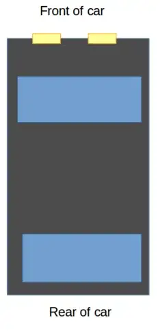

I have a fairly large SUV, and can buy an aftermarket cross-bar roof rack. I've tied down some mid-sized items in the past while camping, but I'm a bit concerned about how I'm going to transfer a few large items from Home Depot:

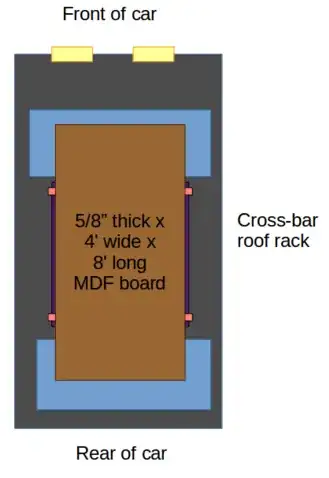

  1. A 5/8" thick x 4' wide x 8' long MDF particle board.

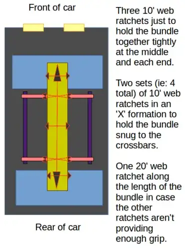

  2. 16 2x4's, each at 6' long.

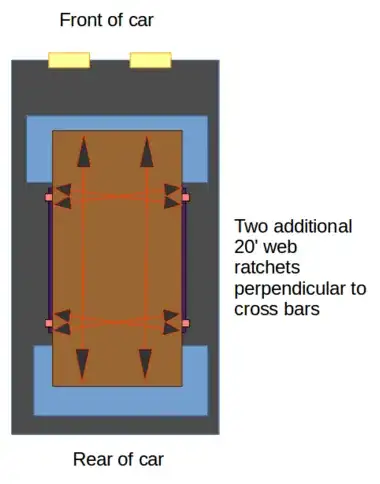

I think I'll have to do two trips. The planned setup is documented below (pardon the obscene number of pictures), and I plan to essentially run web ratchet straps (with band protectors where it comes in contact with the wood) to hold down the load to the cross-bars, and then an extra 20' web ratchet strap along the length of the load to act as a fail-safe. I'll have to drive maybe 20 minutes at highway speeds, and am concerned, especially in the case of the MDF board, of the payload catching too much wind drag and being pulled off the roof (ie: acting as a big parachute).
Does the setup below look sound? I'm not comfortable enough with my knot-tying skills to go with a hitch in place of the web ratchets, unless there are some dead easy knots I could use in place of the ratchets. I do not want to pose any risk at all to other drivers, so if I need to invest in additional hardware to secure the lumber, that's fine with me.

My Car

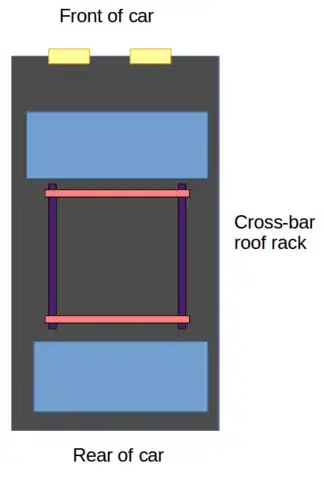

My Car with roof rack with cross-bars installed

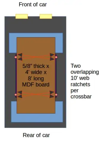

My car with 4'x8' MDF board on the roof rack
4 web ratchet straps in a pair of X formations to hold down the board to the cross-bars

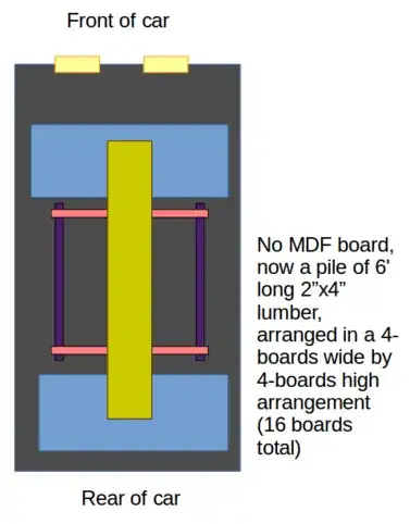

Second trip, 16 2"x4"x6' boards on my roof rack
3 ratchets for holding the bundle together, 4 in X patterns to secure it to the cross-bars, and a 20' ratchet along the length of the bundle as a fail-safe

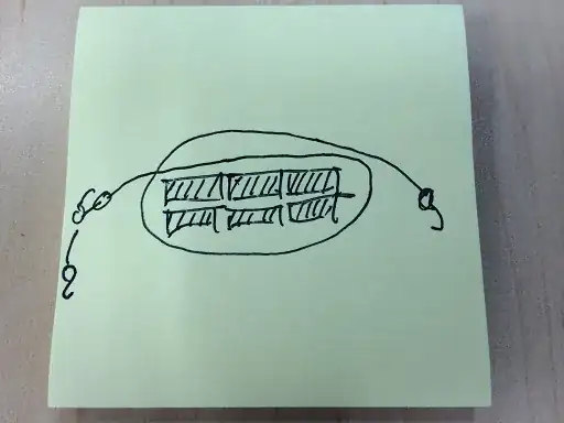

For the MDF, you want the straps going over the edge of the MDF and running straight down to the load boar, so the force is all pulling straight downward. The way to do that is one strap per load bar, in a loop, with the joined hooks and the ratchet mechanism on the same side of the loop. In the following sophisticated CAD rendering, the Sharpie represents one load bar, the Post-It Notes represents one end of the MDF, and the rubber band represents the looped ratchet strap:
This approach will clamp a low, flat load very securely in place. With the straps snug you shouldn't be able to budge it at all. Nevertheless, stop to inspect the load carefully after five minutes and regularly thereafter, and you're right to worry about the parachute effect.
If you're not comfortable with what the load is doing on the highway, hit the hazards and slow down. If people can't pass, pull over every few minutes.
To make the loop, you join the hooks by putting each hook through the eye part of the opposing hook; under tension, that'll be secure:

And here's how I'd put a strap around a bundle of 2x4s on top of the MDF. The loop clamps them together and also grabs them to prevent sliding back. Note that the loop is arranged so the strap crosses at the top, not the bottom. That method would work with sheet goods as well.
