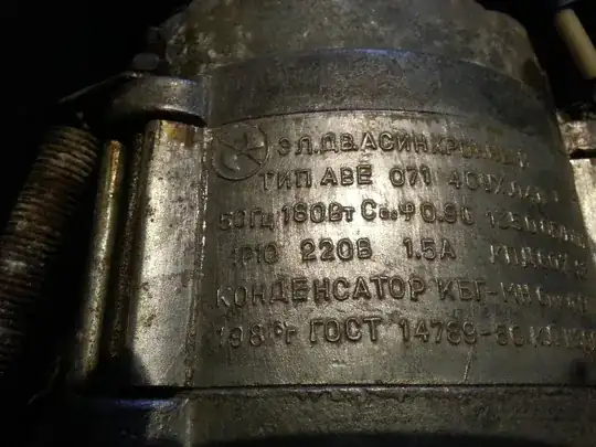

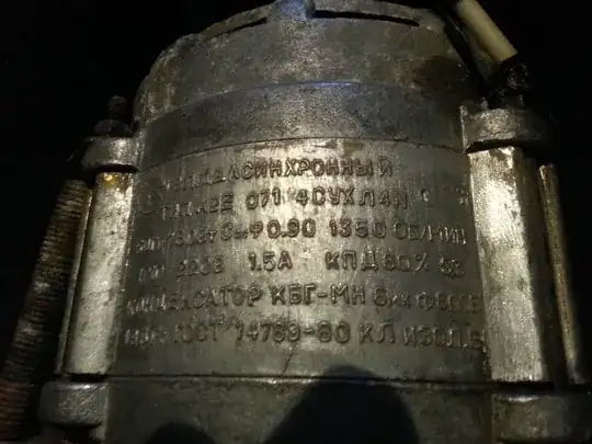

BTW, these are the details from what I've gathered reading the russian 180v, 1.5a, and I think 1350RPM. Here's a photo(s) if you happen to be able to read this:

About the photos you posted: I can see the word "kondensator" which means "capacitor", and "6mkF 600V" which seems to be "6μF, 600V". That most likely is the spec of the capacitor required for operation. I think it reads 50Hz, 180W, power factor 0.9 (cos fi), 220V, 1.5A.
/edit: Ah, I forgot about one thing. Washing machine motors usually are bit more complicated because they have twin windings to be ran in reverse and often have yet another, "high speed" winding for spinning. But that's all in the stator, the rotor is just a hunk of metal just like any other induction motor. If you want to learn more about your motor, google yields some schematics if you ask about this model: https://www.google.ru/#q=%D0%B0%D0%B2%D0%B5+071+4%D1%81
