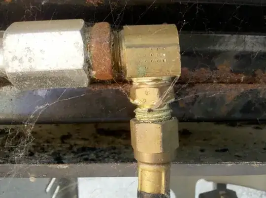

I'm replacing a faulty regulator on my gas grill. When removing the old regulator, I noticed there appears to be some sort of compound on the threads.
Here is a picture of the threads with the old regulator still partially attached: Regulator still attached

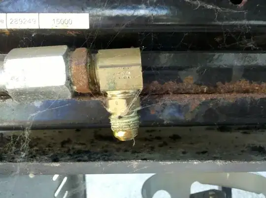

And here is a picture of the threads without the old regulator attached: Regulator not attached

The tape you purchased is the correct tape for gas fittings. However, the fitting in your picture is a flared fitting. PTFE (Teflon) tape/pipe dope is only necessary on pipe thread fittings.
This is because pipe threads are tapered - as you tighten the fitting, the threads bind together and deform slightly to create a seal. The pipe tape/dope helps lubricate the threads and make a better seal.
With a flared fitting like your photo shows, the flare at the bottom seats in a mating flare inside the female fitting. The threads are only there to draw the two together.
Using tape on the flare fitting may not cause any problems, but I would not take the chance, especially with gas. If any tape gets under the flare or prevents the nut from tightening down fully, you're going to have a leak.
