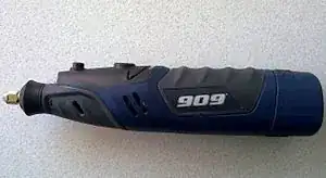

and an electric rotary tool:
What are the advantage/disadvantage between using each one?
Also, which has more torque?
