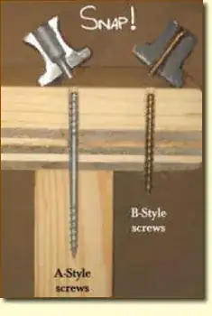

With carpet, for instance, there are special breakaway screws (such as these made by McFeely's) that can be installed from above. With tile or vinyl, the screw from under method is often the way to go.

I have used "Counter-Snap" through vinyl and carpet, and it worked great.
All it takes is to locate the squeak, insert the patented “snap off” screw into the fixture, drill it down and let it snap off.
