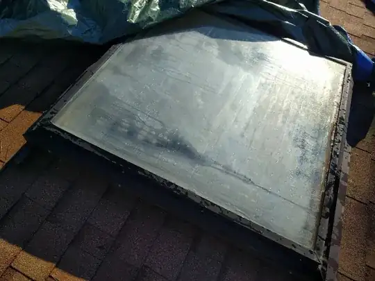

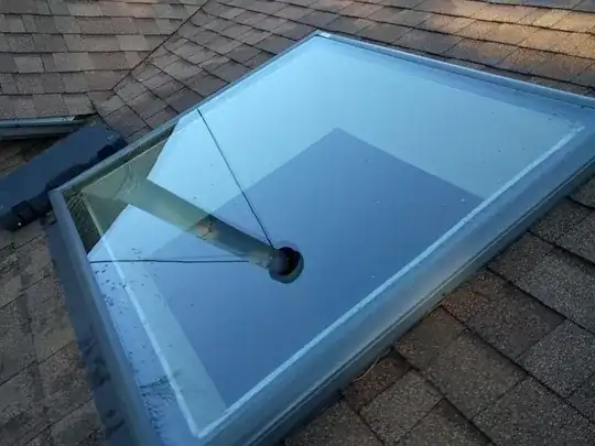

EDIT: I did the work. Here's the followup.
This is before:
old skylight
After:
new skylight

  1. I unscrewed the old one - noting that there were 2-3 screw holes that didn't have screws, and that there were 3 different types of screws that were used.
  2. I Inspected the curb and flashing, making sure it looked sound. It did. I couldn't see any flaws.
  3. I placed a little roofer's caulk in the old screw holes (not sure it was needed, but figured it couldn't hurt).
  4. I placed the new skylight over the existing curb and flashing.
  5. I screwed in the new skylight using the screws that came with it - pressing down on the frame while doing so.
Time will tell but I think it works.

I would never recommend reusing flashing. This is 90% of all skylight leaks. 10% are due to glass failure, glazing issues, frame separation etc. If this solves your issue awesome. if it does not..... there is a flashing, shingle and Ice And Water shield issue. The curb itself is good as long as it is an exact fit to the rubber gasket and seals tightly and is not rotting and a mold issue. Sealing the old screw holes is absolutely necessary. When snow builds up (if that applies to you) it can melt and ice up in those holes and thaw into your house. Hope this helps
user154762
Installing or replacing this type of skylight is very straight forward. The flashing should work as it is. The only concern would be where the old mounting holes are and will the new skylight curb cover the old ones. If not a counter flashing can be added without redoing the flashing.
