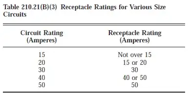

However it's actually more than a recommended practice in this case, it's in the code - NEC 210.21(B)(1) -
NEC Table 210.21(B)(3)
the breaker can't be 40 amp, it has to be swapped for a 30 amp.
