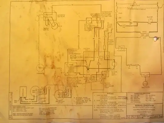

Edit: Furnace schematic

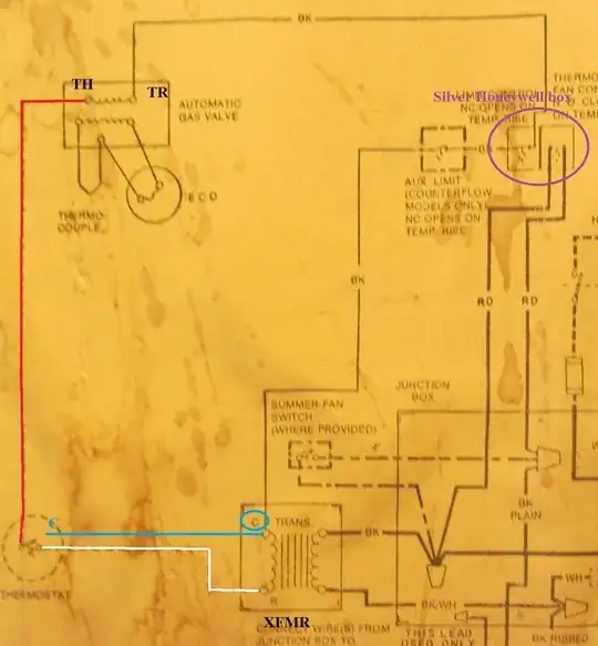

Based on your description of the wiring, and the schematic you've provided, this is what I think is going on.
Click for larger view
It sounds like there's a white wire and a black wire, connected to the secondary side of the transformer. The white wire carries 24VAC to the thermostat, which means the black wire is connected to the C terminal.
So the new thermostat should be wired as follows:
  • White -> R
  • Red -> W
  • Extra (blue in diagram) -> C
You can verify this by measuring the voltage between the blue and white wires, in the diagram above. You should get ~24 volts AC, though it might be a bit higher or lower.
