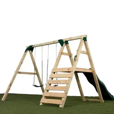

We purchased a commercial play set similar to this.
To cover a 12' span, they use three 2x6" beams laminated together - glue, nails and finally carriage bolts.
This is to support 2 swings and a set of rings.
