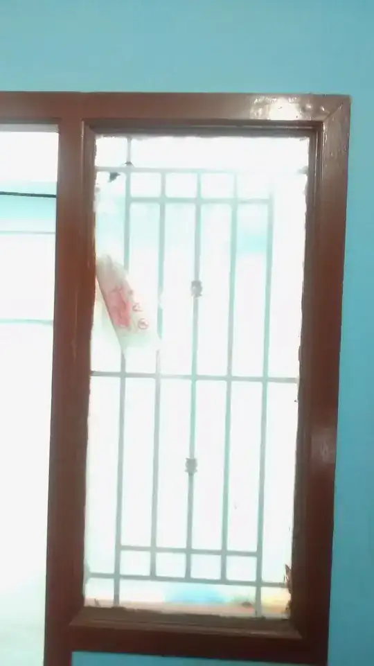

My room has a sealed glass (like window glass but we can can't open and close; its fixed to the frame). Whenever I play music in my 5.1 speakers, the glass starts vibrating making a "errrrrr/grrrrr" sound. It stops when I put my hand on the glass.
Any ideas to prevent the vibration sound, so that I could take my hands off the glass and enjoy the music?

I'd remove the putty holding the glass in place. Check for looseness in the glass - it should be held in place with thin nails running parallel with the glass and into the frame. If it's loose, carefully tap in a few extra nails before reapplying the putty around the edges of the glass.
