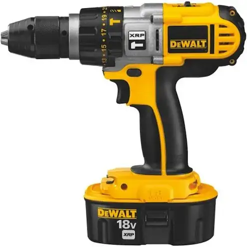

The terms are all a bit muddled these days. But there's cordless/corded screw drivers, drills and impact drivers.
Impact Drivers
Impact drivers have a rotating hammering mechanism that can deliver momentary instantaneous impacts of torque to the workpiece, each larger than the recoil that you feel in your hand. They are appropriate for heavy duty tasks, often things with stainless steel hex bolt heads (though that is arbitrary). Impact drivers have a single gearing usually, and are relatively compact, sporting a quick release hex chuck. Be careful to use only high quality or impact-grade bits in an impact driver. Impact drivers can shatter cheap Chinese pot-metal bits.
Power Drills
Drills lack the hammering mechanism, but have multiple gearings and an infinitely adjustable Jacob's chuck to accept any size bit up to the drill's limit (often 3/8 to 1/2 inch). Drills often included several steps of torque limiting (for driving screws and bolts) and an unlimited torque setting for drilling holes through tough material. A good drill is strong enough to break your wrist if it gets away from you, so apply enormous pressure when using on tough materials. The nicer ones have a screw-on side handle to help manage this. Applying tremendous downforce is also useful when driving screws that are already stripped, or which otherwise want to pop the driver bit out.
Cordless Screw Driver
Cordless screw drivers are generally inferior junk, but could be the right tool if you have an incredibly tight budget and no need to drill holes. They usually have a hex chuck, very low torque, low speed, are small, and cheap to replace.
Everyone needs a good impact driver and trusty cordless drill (or two). Cordless screw drivers are a big step down.
