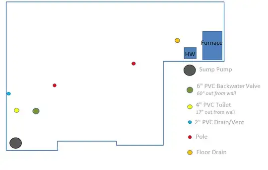

I am trying to figure out how in the world to frame this basement bathroom. As you can see from the image, there is a backwater valve that would end up right in the middle of the room. I know that code requires access to this valve and most basement rough ins have this much closer to the sump pump or other mechanical area, not in the middle of the bathroom.
Any ideas for how I would be able to run walls for the bathroom? I was planning to go off the pole and section off the room, but I dont know what to do since there will be a valve right next to the toilet.

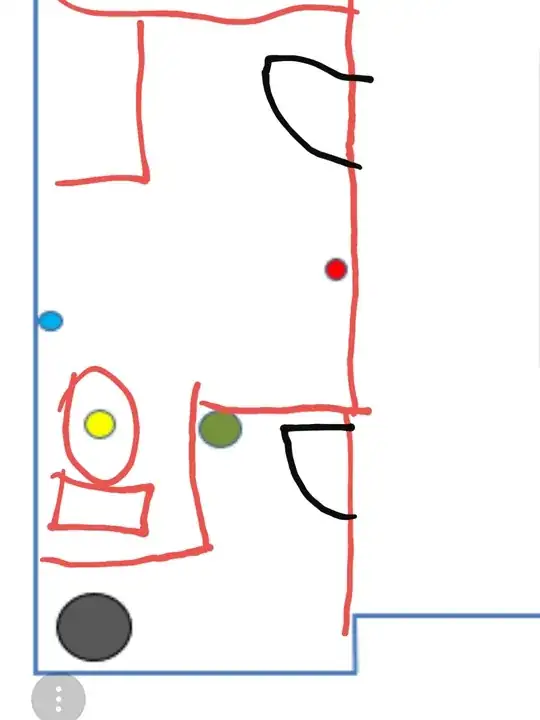

While I totally agree it's the wrong place for the BWV, it's not sticking out of the floor. So, is your problem with doing a finished floor? As far as framing goes, I'd include the sump corner & make that whole end into a closet in the powder room.

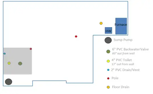

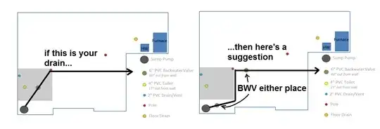

The important question here is where does your main building drain leave the house?Most Municipal codes require the Backwater valve to be the first fixture, if you put it after (upstream)of a floor drain or toilet,you can still flood your home if the city sewer backs up.If the main building drain leaves in the direction of the sump pit , move it closers to the pit and you're good.

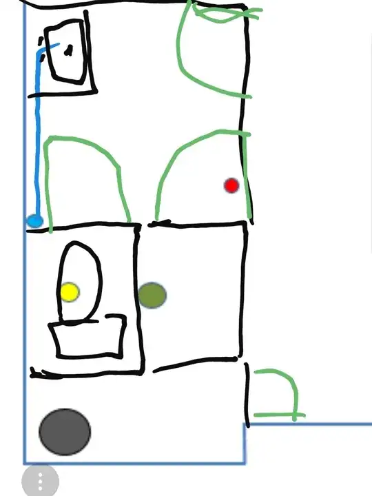

I don't know if this would work because you didn't give dimensions but you can try a configuration similar to the this
You can use the space by the sump pump as storage. Even the towel closet (with the bwv) could be accessible from the sump area instead of from the washroom.

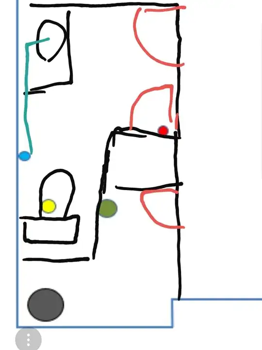

You could try this.
Or this

Generally, you should be able to move your backwater valve as close as you want to the pump, so long as you can access it for cleaning it out. I don't know where your actual drain lines are running, but I'm sure you can find somewhere else that will provide you with access to the BWV.enter image description here
