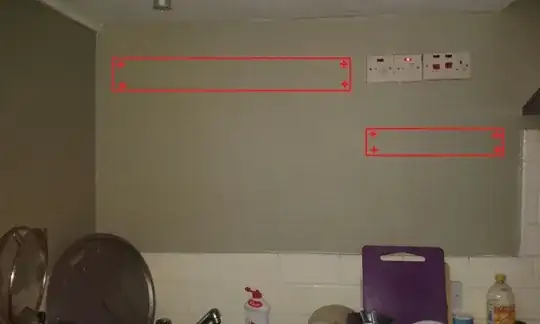

I am putting up some wall rails for my mum, she is not local so I need to go in and do the job in a day so need to get the correct fittings etc in advance.
The problem is I am not sure what material the wall is, therefore not sure which type of fitting to buy.
The wall seems quite soft and hollow when knocked with my knuckle. My mum said it is plasterboard but I don't trust her opinion as she knows less about DIY than I do.
The other side of the wall is a staircase. There are identical wall rails already attached further along the wall out of shot, on the other side of the cooker. The house is about 100 year old, victorian.
1) Would these self-drive plasterboard fittings be a good choice? http://www.amazon.co.uk/Hafele-Plastplu-Rawlplug-Self-Drill-Plasterboard/dp/B00E1LR5JS/

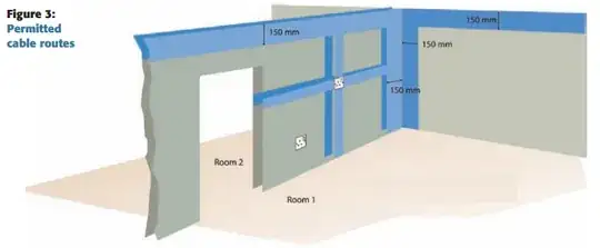

2) Do you think it is safe to screw into the wall in the spots indicated? (as it is close to power socket)
The wail rails are Ikea Grundtal.

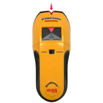

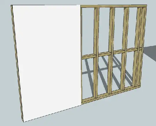

Plasterboard or even plaster by itself is not a very good support for shelving screws unless there are many attachment points. I would try to find framing members, usually vertical studs, and align the screws on at least one end with them. You can use a stud finder to locate the stud.
stud finder

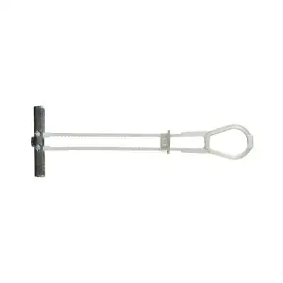

If you cannot align all the screws with studs, on either or both ends, or if the wall is made of plaster over hollow blocks, I would use toggle type anchors instead of the screw in anchors you listed.
toggler
These spread the load over larger area of the plasterboard than screw in anchors, reducing the risk of pullout.
If you cannot align the screws with framing members, a stronger solution would be to mount a board on the wall first, screwing the board to multiple studs, then mounting the shelf to the board with wood screws.

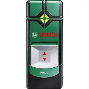

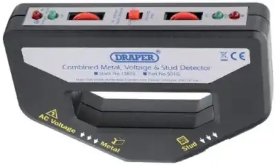

UK Regulations mandate that wires to power sockets must run vertically down to the floor or up to the ceiling or may run horizontally if close to the ceiling.
You need an electrical wiring detector - it will tell you exactly where the wires run.
