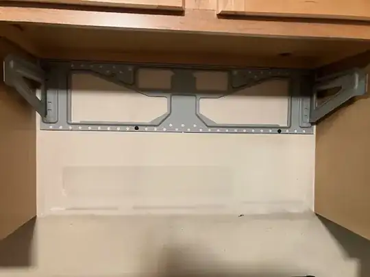

I just removed Hotpoint microwave Model rvm1535bc. I tried to lean it (thinking there was a lip on a wall bracket holding it in place). That didn't work. As it turned out, the under-the-counter rvm 1535 in our house had a bracket that the microwave slid onto and off of. There were also four bolts coming down from the cabinet immediately above it. See photo. Hope that helps someone looking for an answer.
bracket

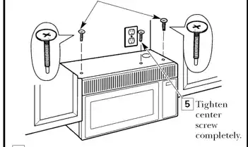

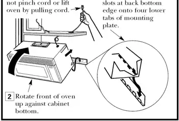

I found an installation guide for a Hotpoint RMV1635 here. With this model, you mount a horizontal bar across wall where the microwave will be installed against, aligned with the bottom of the microwave. You then hang the bottom rear of the microwave onto that bar:
Setting rear of microwave on wall bar
You then pivot the microwave up until it is horizontal, and then use three screws through the shelf above the microwave to hold it up:
Installing top screws
I'm betting the RMV1635 installs just like the RMV1335 you have. If so, then if you take a really careful look at the shelf just over the microwave, you'll either find those screws (they're extra-wide and extra-flat), or you'll find that the shelf removes to reveal a second under-shelf with the screws.
