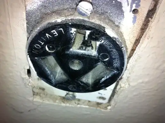

The bed has a 4ft cord bed plug; need to extend another 10 feet to reach 220v dryer outlet 220v dryer outlet.

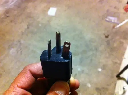

The bed came with a homemade extension, but plug doesn't fit our outlet.
Homemade extension wire is 10 gauge; 15 feet long.
Is it safe to just replace the plug on the homemade extension with one that fits my outlet?

The plug on the tanning bed is a 6-20P plug (250V 20 Amp), but the receptacle is a 10-30R (125/250V 30 Amp), so they aren't quite the same. The tanning bed expects 2 hots and a ground wire, but the outlet provides 2 hots and a neutral (which is almost, but not quite the same)
The "correct" way to do this would be to replace the dryer plug with a properly grounded 6-20R receptacle and replace the 30 Amp breaker in the panel with a 20 Amp. The only difficulty may be in finding a code compliant way to hook up the ground terminal of the 6-20R using existing wiring.

There are 6-20R to 10-30R adapters available, but they are not safe or technically legal
