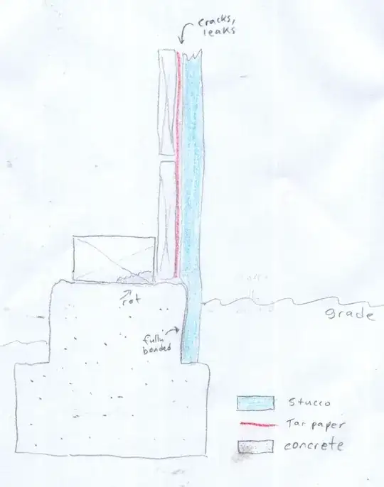

I live in one of millions of older homes that have stucco applied right to the ground, like so:
Stucco to ground
There's really no way to retrofit a conventional weep screed here. Lowering grade is not feasible except in spots. Are there alternative designs?
Note that this is not as bad as it looks: the skip sheathing allows a lot of drying to the inside and except for two areas with overt leaks above, the wood is in good shape. In the leaking areas the sill rots as shown.

I would take an angle grinder and cut a 1" channel in the stucco right where it meets the concrete foundation. Then you can slip some new tar paper into the gap underneath the existing (probably deteriorating) layer. Should help a bit. It's also enough of a capillary break to stop the rising damp and will allow you to inspect for termites.
Long-term, the best solutions would be removing and re-applying the stucco (possibly not as expensive as it sounds) or applying a new layer of stucco over the existing layer, with a few inches of rigid foam between old and new.
