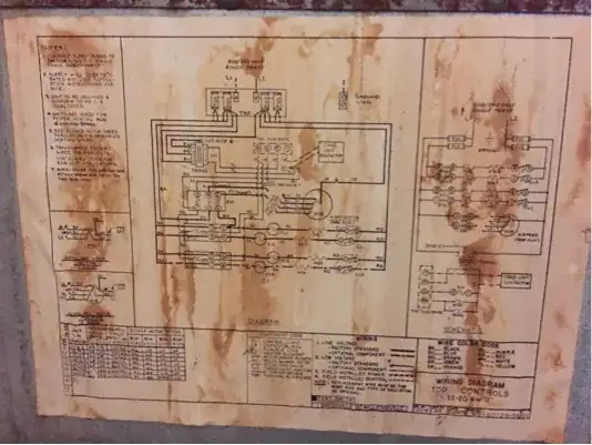

I'm upgrading the thermostat with a Honeywell wifi one. I found all cables at the thermostat end, but can't figure out where to connect the C wire to the furnace (Rheem REAB 1415J).
Wiring Diagram
GeneB
In thermostat wiring, C stands for Common. Look for a terminal labeled Com, which is another abbreviation for common.
I did not look up your thermostat, however it is likely that it needs the common wire to work properly. Many thermostats don't really need a common wire but it is almost always recommended to have one especially with these "smarter" thermostats. More information about the common terminal can be found here and here. Some thermostats have a couple of batteries that they can run off of instead of using the common but that would likely not include a wifi enabled one because it uses more power than a simple programmable model.
I hope this helps.
Maxfield Solar
  • 639
C is the unswitched line from the transformer. 2 wires come from the transformer, look for the one that connects direcctly to one side of every load and find its terminal. The switched line is the other line from the transformer and goes to all the controls. Most systems use C. Trane/ American Std use B.
