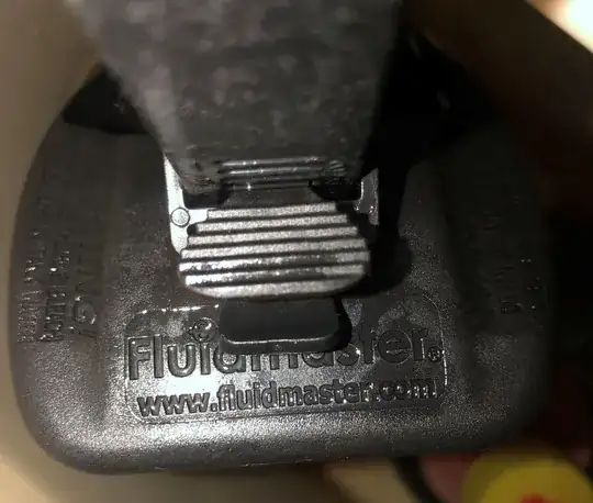

I guess you have resolved this YEARS ago, but since I spend hours even trying to find this part (fluidmaster does not show the part on their page).
Yes, there are a locking piece you are missing there, attaching image of mine ... unfortunately I was trying to adjust mine, and after 'releasing' the lock, I cannot figure out how to lock it again ...
I take this will mainly be useful for other people in the future with the same issue. The piece is going under the pin, and somehow will lock it in place (I might end up trying to figure out on a second toilet), but first see if I can find instruction for how this clip is supposed to work.
The part is the small horizontal part under the long vertical piece.
Close up of floater
