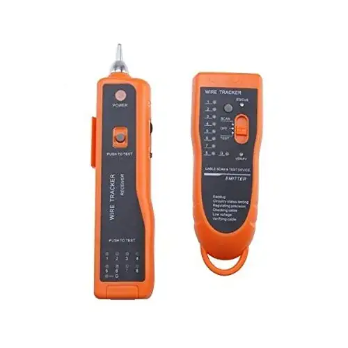

If visual inspection isn't working, you can use a tool called a wire tracer or tone-and-probe kit to track where the cables go in your walls. The tool has two pieces: a tone generator and a probe. You'll either plug the tone generator into an RJ45 port, or open up the drop and clip the tone generator to a wire in the ethernet cable. The toner generates a signal that flows through the cable, effectively using the cable as a radio broadcast antenna. The probe then picks up on this signal (usually a beep or siren type tone) and replays it. You can move the probe back and forth along your walls, and identify the path the cable is taking.
Basic tone & probe kit
Tone and probe kits are not super cheap tools, but a basic comms-oriented one can be had online for around $25 (example). I have a cheap Harbor Freight one that I've gotten a surprising amount of use from in various wiring projects.
