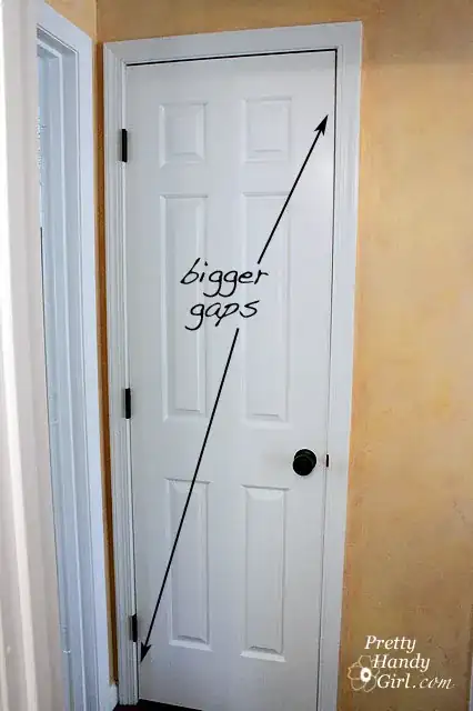

This might be a matter of tightening/loosening screws. Check out this post - http://www.prettyhandygirl.com/fixing-common-door-problems/:
The easiest adjustments you can make on a door is to tighten or loosen the hinge screws. On my closet door (shown above) I loosened the top hinge screws to increase the gap and tightened the bottom hinge screws to reduce the gap.
