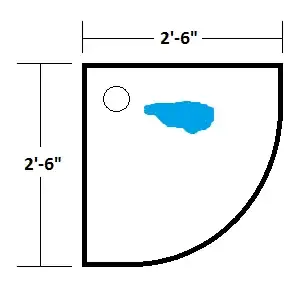

Shower base
Our corner shower is about 2'-6" square with a rounded front and door on it. The drain is in the back corner. As depicted in the image, the blue spot is about where/how the water puddles up in the base and in about the middle of the large spot on the right side of it is where the hole is at. I can patch the hole as much as I want, I know, but this drainage issue will always force it's way through any patch I'd believe, or just sit there in the shower. I know what needs to be done with this base (scrap it and start new), but we'd have to replace the entire shower and I don't want this one hole to be the direct cause of that just yet. So my guess is, is there any sort of compound that I could apply to the base to basically almost create a new slope? Or is there any solution, other than scrapping the shower, to this problem?

This type of shower should not have bounce to it even it has foam underneath to give it a softer touch. The showers are more often supposed to be installed with a heavy layer of thinset underneath to stabilize the pan and to build up any voids. Some showers are a little softer than others but they don't bounce or flex... or they crack and break.
At this point you are asking us internetters what you should do. You are trying to repair it, you are thinking about products and so on. Well you can fix the crack with repair kits. However you cannot fix the flex that is causing the crack. So your repair kit will work until it dries out fully looses its flexibility and then you stand on the area again and it breaks. Maybe you notice a tiny rip... maybe you don't.
Use your resources better - your time and money. The base has to go - for sure. Not only will it be a lot less time to put a new base in but the big issue is the potential damage you are doing to the rest of your house. Water can slowly screw crap up and you don't want a small leak in places you can't see.
To answer your question - you only need enough slope for water to drain. I suggest that you give up on the pan repair and post another question around how you can get that pan out or alternatives for your situation.
