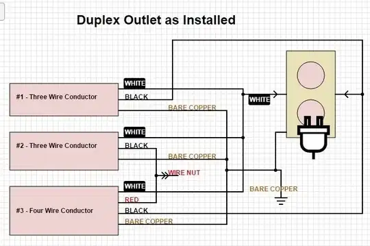

Here's the original installation: Original Installation Sketch

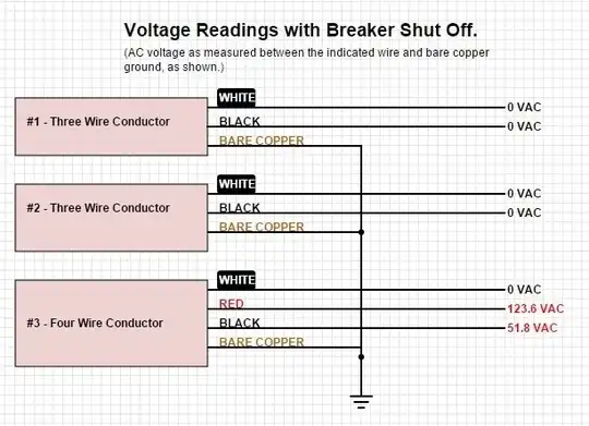

And here are the voltage readings, breaker #23 OFF, duplex socket removed.Voltage Readings
So what's going on here?
  • How is it possible that two circuit breakers are required to be shut off to access a single junction box?
  • Is that even to code?
  • What in a home generates a 51 VAC reading?
  • Why am I seeing voltage on the four conductor line?
  • In fact, why is there a four conductor wire in this box in the first place?
  • I have no clue what's going on here. Any ideas?

Second, what you have is indeed a Multi-Wire Branch Circuit (MWBC) -- the 52V on the black wire with breaker #23 OFF is stray capacitive coupling from the still-live red wire. The red wire, of course, is still live because of another Code violation, this time of 210.4(B):
(B) Disconnecting Means. Each multiwire branch circuit shall be provided with a means that will simultaneously disconnect all ungrounded conductors at the point where the branch circuit originates.
So, it's time to find the breaker that turns off that darn red wire (leave #23 off while you do this!). Hopefully it will be adjacent to Breaker #23 -- in that case, you can get a handle-tie from the electrical supply house and handle-tie the two dodgy breakers together to fix the issue as per 240.15(B)(1). If the builder was as clueless as I fear though, that breaker is somewhere totally else in the panel -- something you'll want an electrician to fix.
