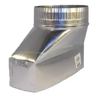

I am thinking of using the top vent option on the hood unit, routing it up through the floor of the cabinet, transitioning to a round 6” duct adapter ant then horizontally through the wall to a 6” round wall vent.

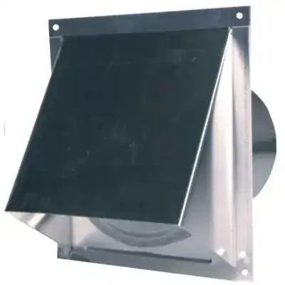

duct adapter wall vent
There is just room for the round wall vent, to the side of the vertical stud. But because of an obstruction on the outside wall, there is not enough room to use a standard 90 degree elbow to the side (away from the stud) and then another 90 degree elbow toward the outside wall.

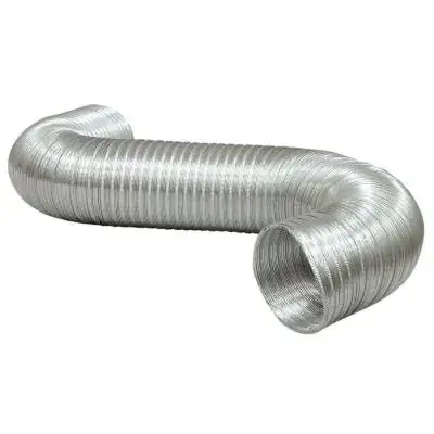

Can I use semi-rigid aluminum ducting (6” inches of course) in this kind of setup?
flex duct
Some of the ads for these products list range hood venting, but others do not. And some specifically say not to use for dryer venting. What are the criteria for an acceptable flexible duct for range hood use? (I do know to avoid the filmy foil-over-spring type.)
Note: I know this question suggests that it can be done on it, but does not indicate which type of ducting is acceptable.
