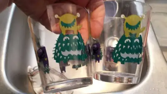

cup comparison
In this picture, the cup on the left just came from the dishwasher. The cup on the right came from my cupboard and was ran through using a rinse aid before the softener was replaced. Previously without the rinse aid, you wouldn't have been able to see my fingers through the cup.
