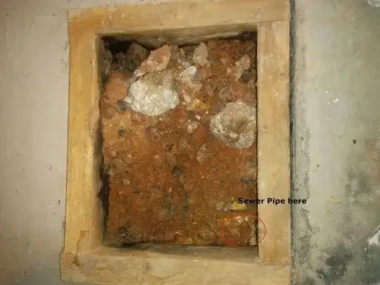

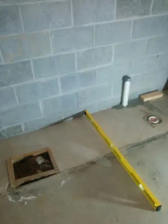

I have a plumbing rough in that is located below grade in my basement. The system consists of a 2" sewer pipe and a toilet rough in connected to an ejecter tank. In the middle there is what appears to be a french drain that is open to the ground. Not sure what it is for and if I can cover it up when I finish the bathroom?

That's for a shower drain. It's common to leave an opening about that size to allow for slight variation in tub position, manipulation of the trap assembly, etc. You should find a stub under the dirt. Normally you'd remove the lumber, which was a temporary concrete form.
