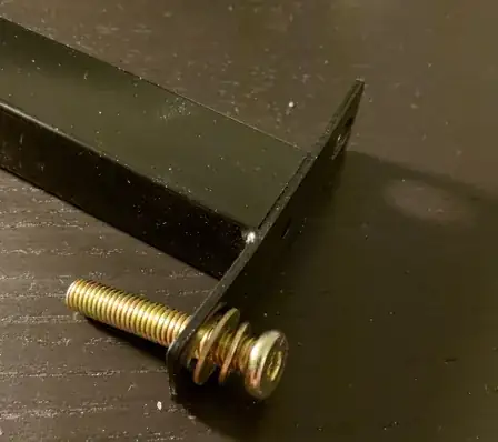

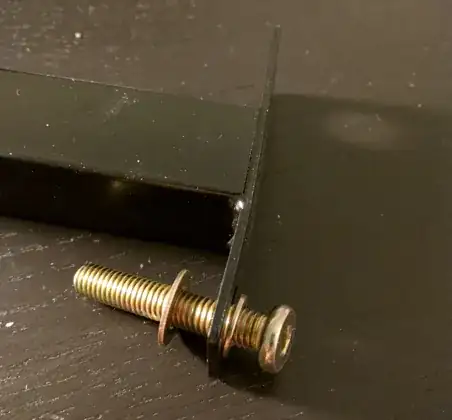

So, I got a screw and things that look like rings (washers). One of them looks like incomplete ring (C-shaped), another is really a complete bigger ring.
The assembly instruction says I need to put both types of washers on the screw.
But on which side?
Should they be on the different sides like this:
Or should they be on the same side like this:

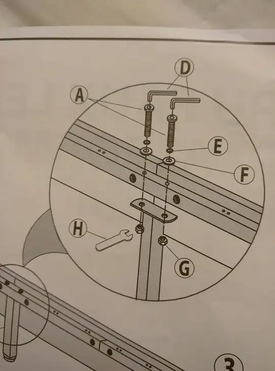

However, the instruction says this:
According to this, it looks like
head, C, O, material, nut
But several people answered my previous question that it's
head, material, C, O, nut
I am confused at this point. Could you please explain?

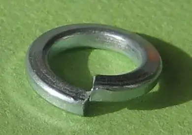

It's hard to tell from the photo, but I believe the "incomplete ring" you mention is a "split" or "spring" lock washer:
If that's the case, then the are stacked as you have them in your second picture, the flat washer against the bracket, then the lock washer on top of that.
Note that this assumes that you don't have a nut that goes on the screw, if that's the case, then it's possible that the lock washer goes against the nut and the flat washer goes under the bolt head.
Based on the diagram you provided in the edit, it looks like the diagram wants you to put them in this order:
That looks like it's a wooden bedframe, so the flat washer is there to give a bigger surface for the bolt head when it screws down onto the soft wood.

TYPICAL installation is screw, materials, flat washer, lock washer, nut.
But for some reason, the engineer requires the assembly be in the order of screw, lock washer, flat washer, materials, nut. And that is the sequence you should follow.
There are materials types and clearances, I presume, makes the engineer require this order.
Also, it looks like the nut is a nylon lock nut. Which precludes the need for a lock washer next to the nut.
When you install the nylon lock nut onto a bolt or threaded stud, the nylon insert wraps around the threads and locks the nut in place. This gives a nylon lock nut a distinct advantage over a lock washer when the bolt or threaded stud is subject to vibration, as the nylon lock nut is unaffected by vibration.

"Picturing" that the screw goes into a deep thingy, I'm voting for the second shot & indeed the washers stack. The hole in the bracket looks pretty big & too big for the smaller washer, but I'm also imagining the screw head would go on the other side.

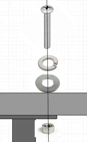

Those are called washers. The 'c shaped one' is a split washer (we refer to it as a lock washer) and the complete one is just a regular washer (flat washer). They go on the thread end of the screw, inside of the material, so...
Screw head
(Hole in material)
Lock washer
Flat washer
Nut
The lock washer is used to basically press into the material to grip onto it. The flat washer is used to create an even distribution of pressure from the nut. Both also create a larger holding surface for the nut and bolt to connect everything.
