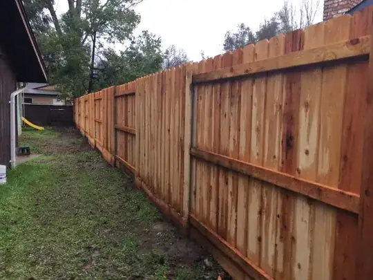

This fence was built with angled boards. The guy who did it said that would help with wind resistance. The fence is about 90 feet long, and the part of it down the fence line gets hit pretty hard when there are heavy winds. (The area closer to the camera in the first pic is sheltered more because of the houses.)

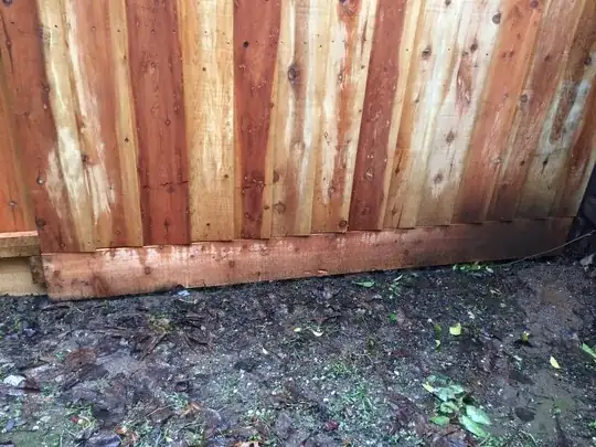

The second image shows how the boards were angled. The fence is about 7 feet tall.
The posts are metal.
Will this style of fence help with wind resistance? I'm not sure how angled boards, versus boards that are side by side, will make much of a difference, since the wind will be pushing against the fence no matter what. There are no gaps to allow air through.
Edited because someone said in the comments that it looked like he was building a shiplap fence, but after looking up shiplap fences online, it doesn't seem like it was a correctly built one. This Imgur album shows how the boards were put on. They're not wedge-shaped, and they weren't made to fit together -- they're basic fence boards that you would normally put flat against the rails.

If you mean will it block wind, then yes & quite well. If you mean will it hold up in the wind, as you indicate in comments, then yes it will but not long. However, the construction problems you mentioned don't have me convinced either that the boards will stay on past 5-years. Amongst many other components, due to that haphazard nailing.
2 other concerns are that it's seated on the ground & the bottoms (& up to 3') will rot out & look like termite damage in under 10-years...wetness wicking already witnessed by the camera. And, being over 6' tall is likely a local code violation. Which, frankly is a good thing because it's your only possible avenue of recourse in getting it removed or at least done a little closer to right.
