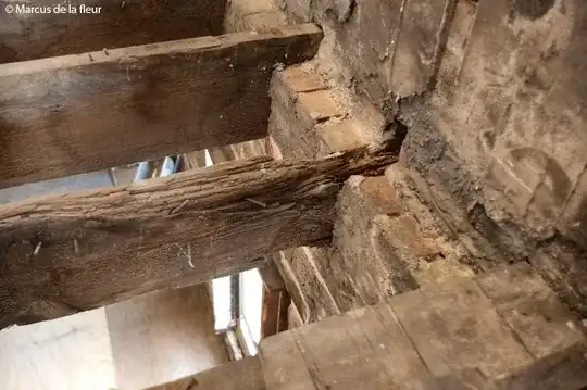

Now, if you're lucky see if you have slots instead of pockets, this you can work with to get new beams in. Meaning, can you see the full pocket & a subfloor gap or does the subfloor seem to go into the brick? Lucky
If no, then one very successful (& proper & legal around me) method is to put or leave full depth scabs in the pockets. PocketScabs

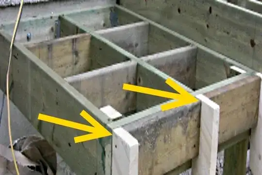

Just to kind of give you another view of the practice of framing in a new floor structure with old &/or new lumber. It looks something like this with the scabs being on the backside of the ledger or the light wood (it's a bad & wrong picture, but the best basic visual I could find). NewFrame

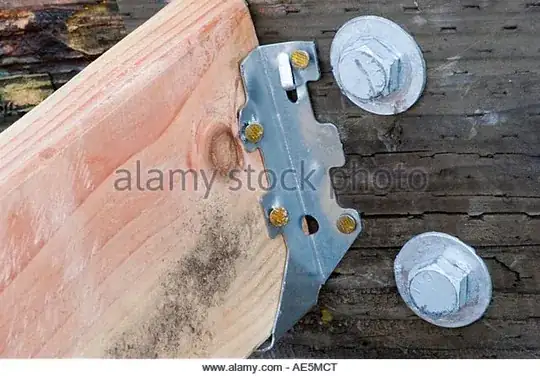

You would supplement the lags with upside down joist hangers on top of the scabs, since lags don't have the full shear resistance of a 2x8. Again, just for your visual understanding if the carpenter starts explaining what he'd do & it happens to sound like this. Or, see what he thinks of this, him falling down laughing would be explanation enough.
The benefits of the above method is that nothing changes, the pockets keep doing what they've done, the structure remains braced, no damage is done to any brick in trying to coax new beams in that may be too long & outwardly stress the structure & the new ledgers & joists can be custom heighted. But, hopefully the carpenter's just fine with leaving them in.

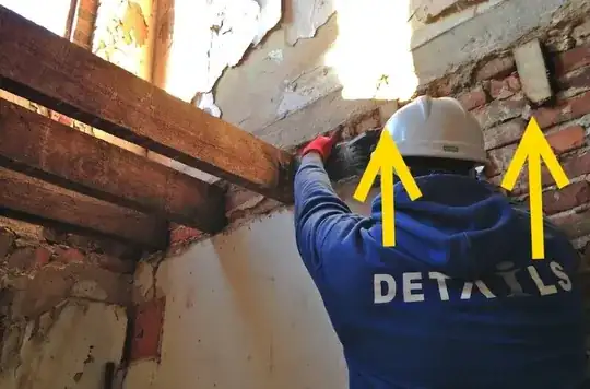

TL;DR: Install new joists without removing the old ones, fastened the exact same way the old ones are : No ledger board and no sleeve anchors. Pocketed into the brick.
You make new pockets for sisters, and you keep the sisters as large as possible while still being able to squeeze them in there. If you have a center beam to support the other side, insert the sister in sideways and then 'flip it up' with a 5 pound sledge and a block of wood. Then tap it into the pocket from the other end.
If the other end is going to be joist-hung, cut a slight angle* on it, so that once one end is inserted into the pocket, the other will slide right into place.
Then use 1\4" structural wood screws to attach the sisters to the existing joists and then mortar what's left of the pocket (with the appropriate material), having removed as much lose debris as possible.
