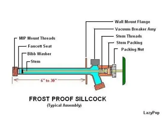

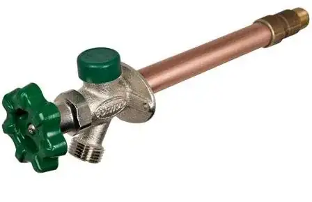

A common device used in the US (and required by some building codes) is a water outlet that is long so that turning off the water allows the portion exposed to the elements to dry out. These are called "Frost-free" or "freeze proof", etc.:
They come in different lengths, and the actual valve is all the way to the right of this picture where the copper meets the brass. This causes the entire valve to drain so no water is exposed to outside temperatures. The actual water pipes will be well inside the wall of the home and will generally not be exposed to freezing temperatures.

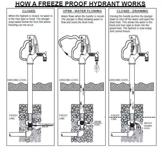

Here is another diagram to help explain from this answer:

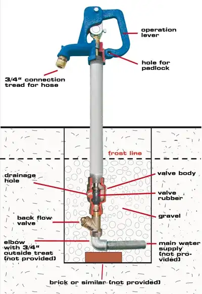

Fist gotcha is that nothing is actually freeze proof only freeze resistant (you were right to word your question that way) up to a certain point. Heating units are about as 'proof' as you can get, until of course they fail for whatever reason, and of course they have their own other drawbacks.
That said, assuming you want or need the bib to be located closer to the garden, what you may need is a Yard Hydrant. These will drain the water in the pipe down below the freezing line in the ground. You'll have to run a pipe to below the frost line, which varies on depth based on several factors such as temp and type of soil. Talk to local builders or city officials to find out what the frost line in your area is.
Yard Hydrant-1
Yard Hydrant-3
(The actual hydrants have much longer standpipes.)
These hydrants are great but they are expensive starting around $120 USD and up. Most installation instructions forget about telling you to put some kind of stone or block under the elbow fitting at the end of the pipe in order to support it better. You should also put some drain rock below and around it and I recommend some landscape fabric surrounding the drain rock.
For more information on what and where the 'Frost Line' is: nsidc.org
I wish I could post more links but my reputation isn't high enough. ... a little help here ;)
JaredW82
  • 257
The freeze proof bibs above work on the wall of a house. If you want the faucet further from the house this hydrant style works great. The supply line is buried below the freeze level and the base of the unit is bedded in rock when you turn it off the water drains into the rock. We have 3 of these for our horses and they have never frozen. I plan on replacing our other 3 standard bibs this summer as they always freeze and break the valve.

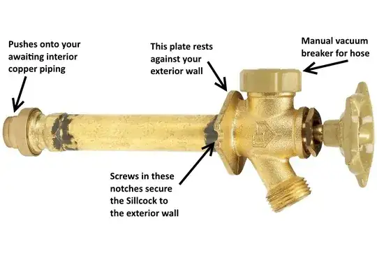

No piping nor material is "freeze-proof" when full of water & in your application it shouldn't be tested. But, I agree with JPhi1618 get a Freeze Proof Sillcock to accomplish your project.Sillcock
Here are a few tips to using them optimally:
  1. Angle the handle end down slightly from the interior connection so it always drains completely after every use.
  2. Caulk the backside of the mounting plate after the exterior wall's hole has also been caulked or foam filled so air doesn't enter the house, have any possibility of getting to the interior's valve & inside heat can keep the majority of the valve above freezing.
  3. Partially Unscrew the Vacuum Breaker cap for anything left connected to the Sillcock in freezing weather, this protects the Sillcock & whatever's connected only if that item drains completely by gravity. Ideally, nothing should be connected in those conditions & they will be damaged or destroyed if they aren't separately & fully drained.
