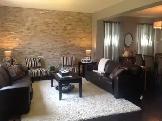

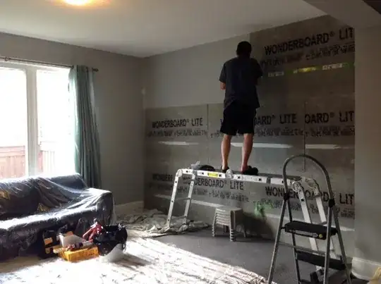

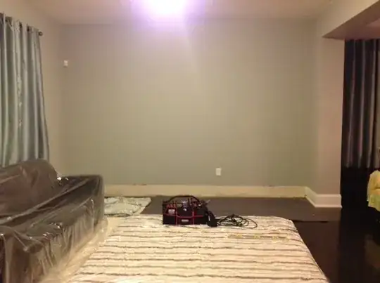

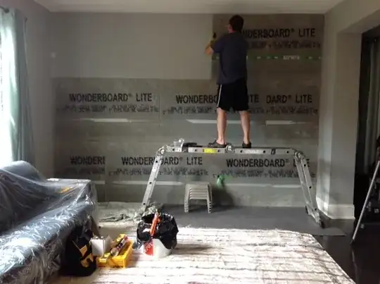

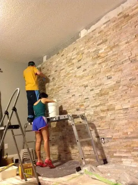

Here's the project that we completed last month. thanks to Iggy and D moore
