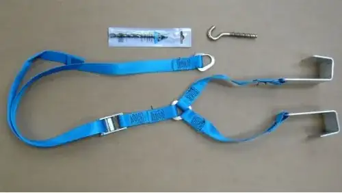

I used eye-bolts to anchor my ladder to my wall.
random intertube photo - I just used rope and carabiners etc

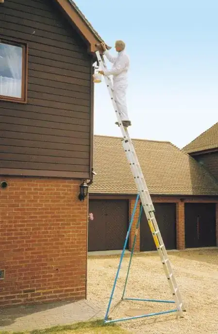

If I needed more security I would probably buy ladder-stabilisers or lash a plank to the bottom (less likely for ladder to rotate) and maybe buy a harness to clip myself to the ladder.
